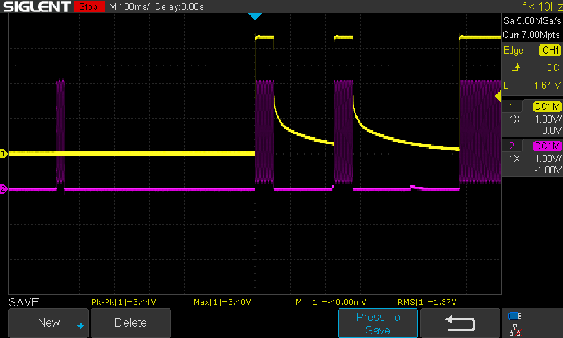

As I have an unmodified NUCLEO-F767ZI attached to my PC, I updated the ST-LINK on it to the latest (V2J40M27) version and took some measurements. Here is an interesting picture:
CH1 is VDD for the main MCU and CH2 is HSE clock from the ST-LINK's MCO. The clock starts 35 us before the VDD starts rising. The lone clock burst on the far left is 4 ms after the USB/power (ST-LINK) is plugged in. NRST line is held low almost all the time and is released 50 ms after the third (and last) "VDD on". Though there is also a 3 ms long spike on NRST 50 ms after the second "VDD on". I guess those "VDD on" intervals could also be dependent on a USB host. If the board is powered from a simple USB power supply, then there is just a single normal "VDD on", but it happens after a 2 s initial delay.
It should be noted that by default the HAL/Cube applies a 100 ms timeout for HSE startup. Therefore, if the board is powered externally and NRST is disconnected from ST-LINK, the code will definitely fail on power up. If the goal is to use the clock from ST-LINK, then it's better to leave NRST connected also. And update the firmware because, for example, the V2J38M27 doesn't release the NRST without PC at all.
P.S. What do you guys think about that "triple start"? I do understand that there is a bootloader etc., but still it seems to point that the firmware is written by the same HAL/Cube geniuses...
