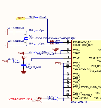

Clk is coming from st-link , so you have to power the st-link, to get the 8MHz clk,
or set solder bridges + a crystal connected to F767,
or use only internal HSI clk in your program.
Boot0 at gnd , is always needed, if you dont want to start the internal bootloader.
NRST has to be separated from st-link, if you dont power it; so power st-link, even if you dont use it -
or separate the F767 reset from not powered st-link.
Just look at the circuit of your board, to see, what to do .

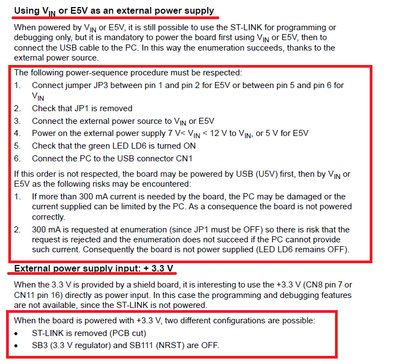

Please refer to the UM1974 page 23:
For 3.3V power supply: you need to remove SB3 and SB111 to disconnect ST-LINK from the main MCU because it's keeping resetting it.
2024-06-14 7:23 AM
Sorry no, my external power is 5V, not 3.3V.
So can I remove SB3 and SB111 like 3.3V?
2024-06-14 7:34 AM
No, so you need to read the first section (VIN/E5V) and apply the described power sequence procedure.
