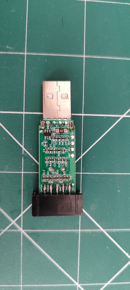

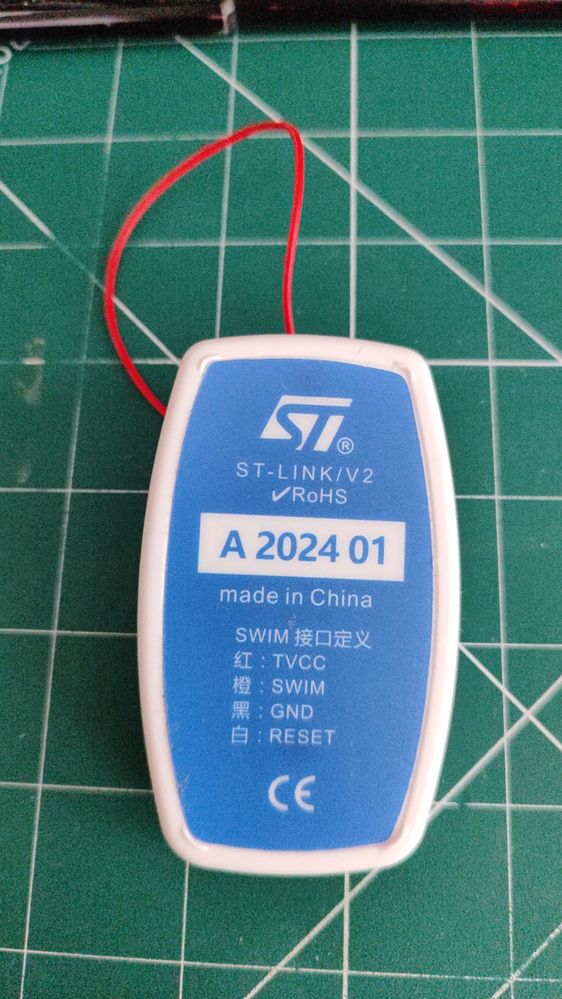

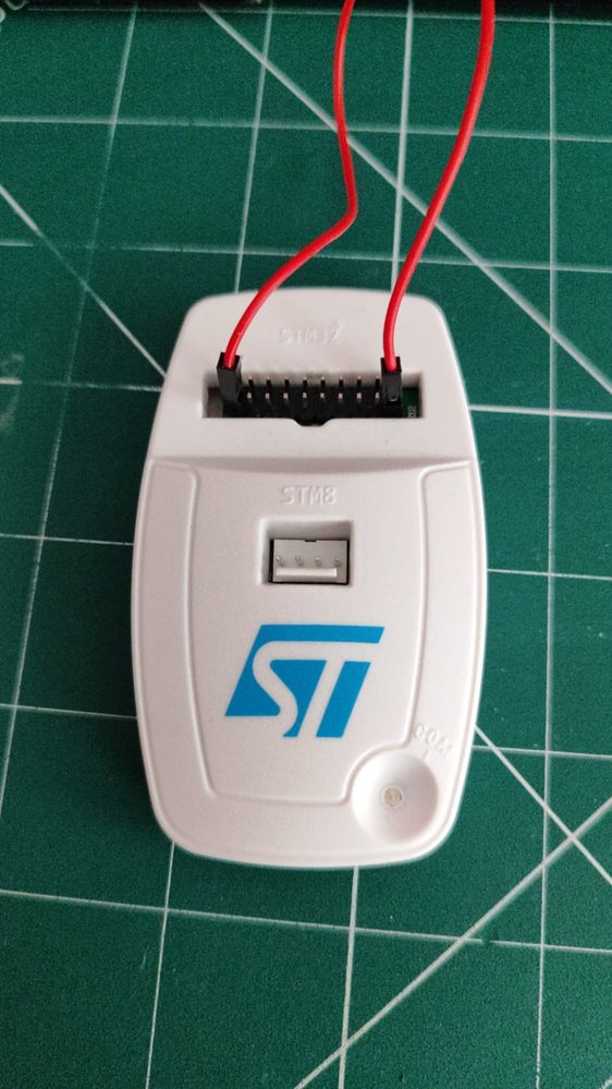

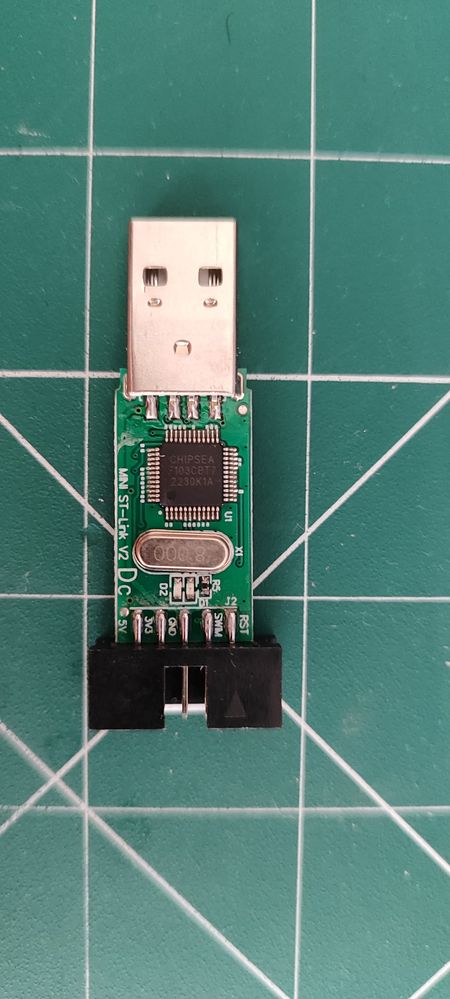

Please upload a legible photo of your ST-LINK (front and back).
Regards
/Peter
2025-03-25 3:57 AM - edited 2025-03-25 3:59 AM
Thank you for your response. I'm happy to be among you.. I tried to flash the program using both ST-Link V2 Mini and ST-LINK/V2, but I was unsuccessful. Both ST-Links were tested on other boards and are working properly.
2025-03-25 5:36 AM
Unfortunately, I have to inform you that both ST-LINK/V2 are clones, i.e. equipped with fake STM32F103 and stolen firmware. However, software of STMicroelectronics can only support original hardware. Ok, the hardware costs a few bucks, but the very extensive software including all libraries is completely free to use.
Regards
/Peter
2025-03-25 5:55 AM
I didn't know this. I will immediately acquire an original product. I assume you think the issue might be related to this hardware. After conducting my tests with the original product, I will write to you again. Thank you for your help.
