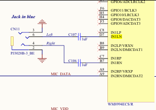

The problem could be on the evaluation board because the line input is a mic input, so probably I saturate the input with my signal.
I will check tomorrow if this is true.
2024-08-04 7:35 AM - edited 2024-08-04 7:36 AM
I have modified the source WM8994.c to exclude the +30dB gain on input
Now the my signal does not saturate the input but still strange output:

Do I have to apply a conversion to the smr_dynamic_param value ? because in the example there is a * 0.25.
case INPUT_DEVICE_INPUT_LINE_1 :
BSP_LCD_DisplayStringAt(10, 80, (uint8_t *)"--INPUT_DEVICE_INPUT_LINE_1--", 0);
/* IN1LN_TO_IN1L, IN1LP_TO_VMID, IN1RN_TO_IN1R, IN1RP_TO_VMID */
// 0x0011 = 00010001
// | +- IN1RN_TO_IN1R
// +-- IN1LN_TO_IN1L
counter += CODEC_IO_Write(DeviceAddr, 0x28, 0x0011);
/* Disable mute on IN1L_TO_MIXINL and +30dB on IN1L PGA output */
//counter += CODEC_IO_Write(DeviceAddr, 0x29, 0x0035);
// 0x0035 = 00110101
// +++ 0dB
// + +30dB
// + unmute IN1L
// 0x0025 = 001000101
// +++ 0dB
// +-- 0dB
// +--- unmute IN1L
counter += CODEC_IO_Write(DeviceAddr, 0x29, 0x0025);
/* Disable mute on IN1R_TO_MIXINL, Gain = +30dB */
counter += CODEC_IO_Write(DeviceAddr, 0x2A, 0x0025);
