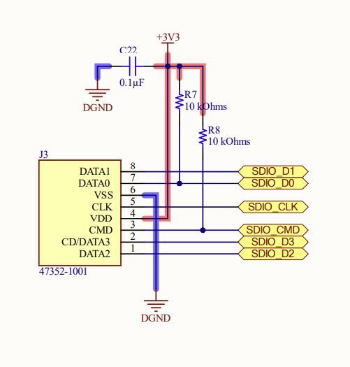

This is the schematics of the card connection

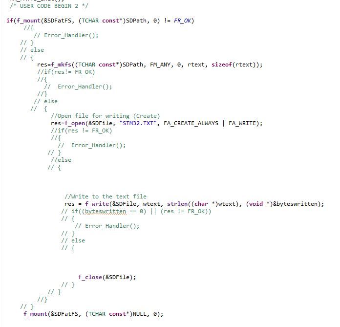

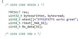

and this is the code that I run
at f_mkfs() function it returns FR_NOT_READY. If I continue to run the code and run f_open() it returns FR_INVALID_OBJECT.

1.Could the first result be cause by the fact that Card Detect and is connected to ground and if so how to fix that in the code? where that function is located?
2. Could this be due to wrong frequency on SDIO? I used 48, 25 and 16 and all with no result.

Debugging tips.
Don't use ANY Write functionality until you've proved the Reading works.
You don't / shouldn't have to format the cards with f_mkfs() all cards in the stores come preformatted properly / ideally.
The PLL should be running, typically at 48 MHz, and you divide down from that. MicroSD cards should be good to 50 MHz, you're interface might not be. 25 MHz or 12.5 MHz should be reasonably safe.
Use DMA, disable flow-control
Most important code is in the DISKIO layer, the top-level code is going to be next to worthless from a debugging perspective. Code here should check the card presence via a GPIO, typically to a switch on the socket design, normally with a pull-up, grounded when card inserted. Not required, null-out related code.

Hello @MBolo.1,
f_mkfs() returns FR_NOT_READY. One of the following possibilities is suspected:
Would you check if FF_FS_REENTRANT is enabled or not? note that the low-level disk I/O layer must be reentrant. Check UM1721 section 4.4.2
