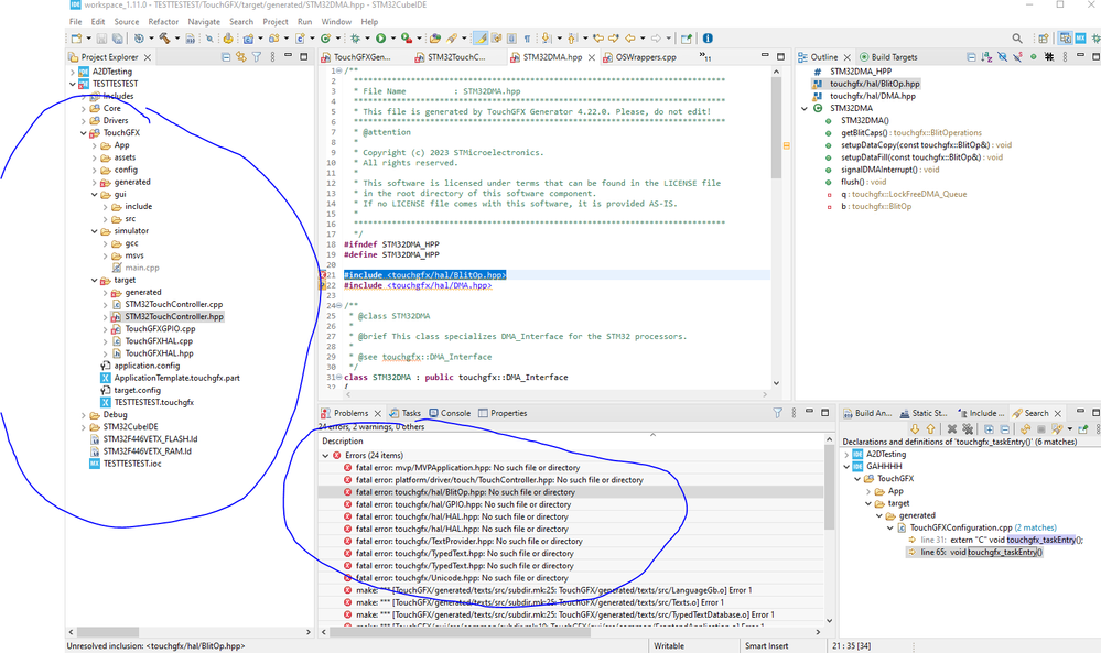

I'm trying to work with touchGFX, but I'm struggling to get it to compile.
I downloaded the latest version of cubeMX as of today, 7/8/2023, then started a brand new project for an STM32F446VET
I enabled X-CUBE-TOUCHGFX version 4.21.4, enabled the CRC, and set the clock to 180Mhz. I then imported the project into CubeIDE as an existing STM32CubeMX configuration file. I went into touchGFX, created a blank display, ran the simulator, closed it, then tried to compile the code and I'm hit with many "no such file or directory" errors. The directories do exist, I can see them in the file explorer
If I edit the offending include to point directly to the file in question, the error does seem to go away but I'm hit with about 30 more, different but similar, errors, I attempted to go into properties -> Paths and Symbols and adding in every combination of the directory I could think of but that made no difference.
Anyone have any ideas on what the issue might be?

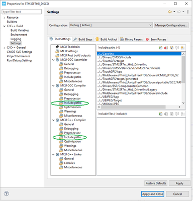

I disabled Generate Under Root as per the first guide
I verified all necessary Include Paths were present for both the MCU GCC and G++ compiler's, except for /TouchGFX/platform/os as that directory is nowhere to be found.
I verified all the necessary compiler switches are present for the GCC compiler, but not the G++ compiler. I attempted to add them into the GCC compiler under Miscellaneous -> Other Flags and that made no changes.
The core library path is present in the linker options. However, many of the suggested options were missing. I attempted to add them in under MCU G++ Linker -> Miscellaneous -> other flags and that made no changes.

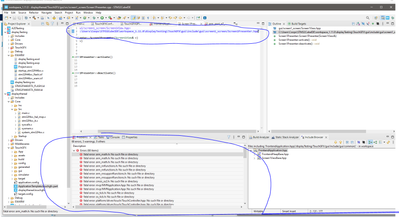

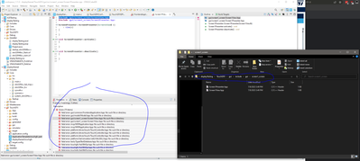

I'm having the same problem. Sequence of events:

I am also having a similar issue. Has anyone resolved the issue yet?

Having the same issue. Has anyone resolved it yet?
