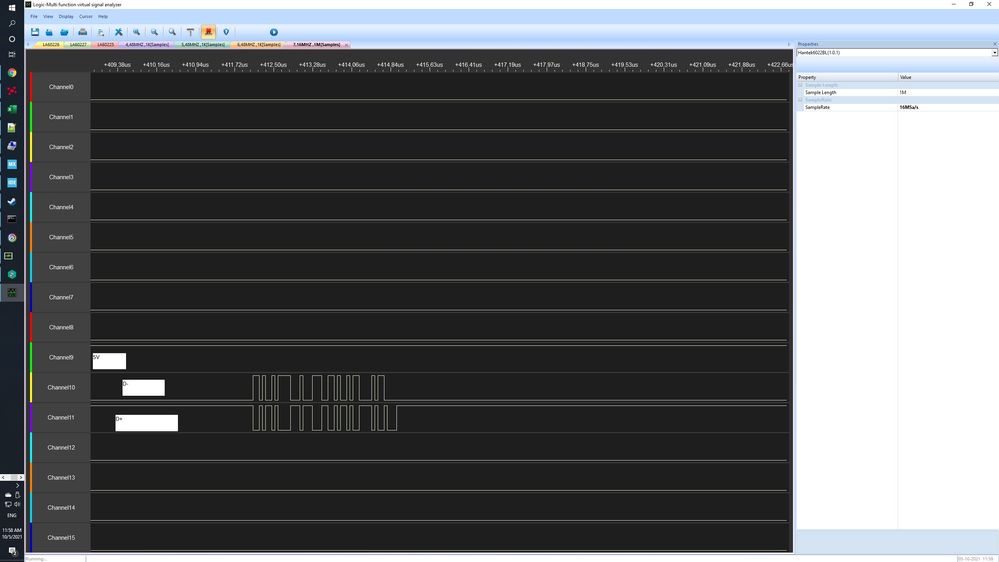

Today a connected the logical analyzer to the usb connector to see what signals I'm getting and this are the signals
0693W00000FBXOmQAP.jpgthe rest of them a repeating and they are similar to this one.
