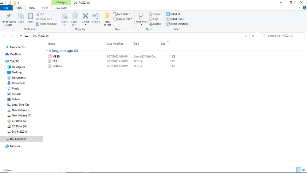

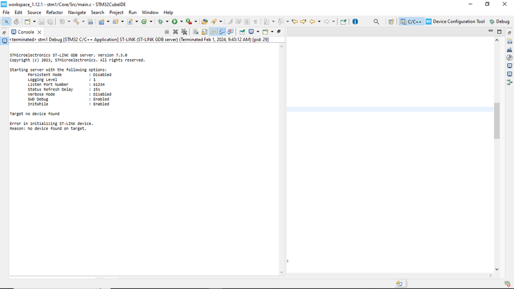

The stm32f429 disc1 board is throwing this error once I connect my board.
The interface firmware FAILED to reset/halt the target MCU.

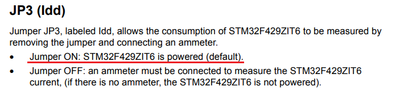

Check if JP3 is already fitted:
I have a doubt that it is not fitted, therefore the MCU is not powered on.

2024-02-01 5:33 AM - edited 2024-02-06 2:00 AM
