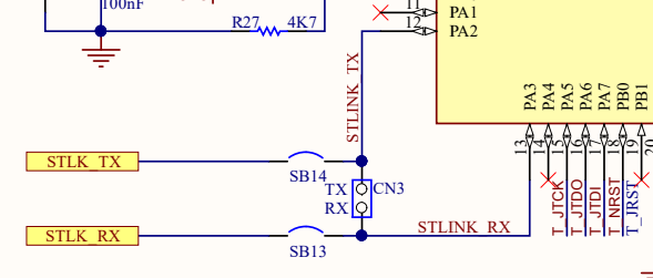

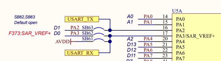

This is not a "problem" - this is clearly documented in the User Manual for the board:
via: https://www.st.com/en/evaluation-tools/nucleo-f411re.html#documentation
You can also see it in the schematics:
https://www.st.com/resource/en/schematic_pack/mb1136-default-c04_schematic.pdf
via: https://www.st.com/en/evaluation-tools/nucleo-f411re.html#cad-resources
@JaunAlejo wrote:all data I send ends up on the COM9 (ST-LINK VCP) of my PC (USB micro connector), not on the physical pins PA2/PA3.
That's not true: the data does appear on the physical pins PA2/PA3, and those pins are then connected to the ST-Link's VCP:

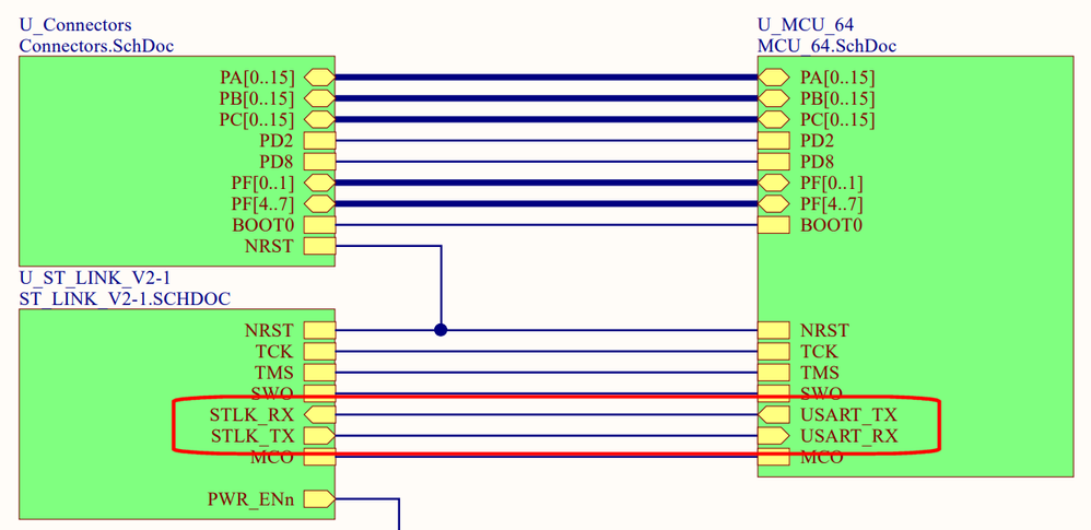

@STTwo-32 But it does seem unhelpful that the nets have different names on the ST-LINK and MCU sheets - which rather obscures the connection.
Everything else that's connected between sheets has the same name on all sheets.
