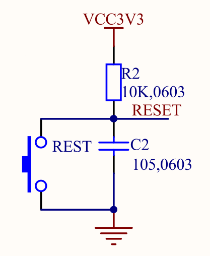

Your pulldown on reset/boot is useless because when the button is open, it is connected to nothing.
You can use something like this:
wrong. There is an internal pull-up, see "Figure 4. Reset" circuit in der app note mentioned above.
