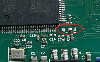

Hello! I've designed a PCB using STM32F407vgt6 but I cannot get it to connect using ST-LINK/V2 via the SWD interface. When I try to connect using STM32 ST-LINK Utility, I get the following error:

I've confirmed that the SWDIO pins, power, NRST and BOOT0 and BOOT1 are connected correctly per the wiring diagram using a multimeter and inspected all other solder joints and they all look okay. I also tried adding in 10K pullups to 3.3V on SWDIO and SWCKL but it didn't help so they are removed in the picture.

2025-02-24 3:53 PM
FB1 isn't there, so VDDA isn't powered. It's not going to boot up without VDDA. It's not optional.
Could be other things.

2025-02-24 4:01 PM - edited 2025-02-24 4:01 PM
Thank you! Since I'm not using the analog peripherals, can I simply add a jumper across FB1, or is proper filtering required?
2025-02-24 4:05 PM
A jumper will work if all you want is connectivity.
If it's still dead, measure VCAP voltages. Soldering looks a bit questionable, might want to recheck for bridges or cold solder joints. Measure voltages on the pins themselves if you can.
