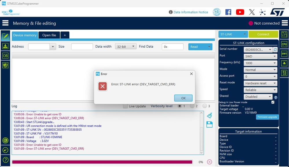

The initial tests were conducted using CubeProg 2.19 with updated firmware on all programmers (target MCU on 3.3V). I have now verified this using the latest version of CubeProg 2.22 and updated firmware on the MINIE (now target MCU run at 3.0V). The results are the same.

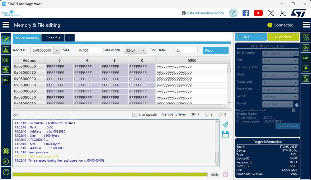

Screenshots:
Stlink V3 SET
Stlink V3 MINIE

On miniE target shows 0,0V !  this cannot work.
So power the target. (or you didnt connect the miniE VCC sensing ?)
miniE dosent give out power / 3v3  !
