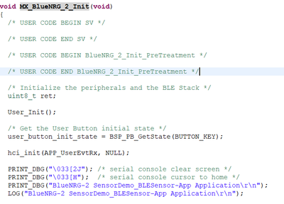

Note that you can paste the image into the post - then we can see it in context:
But please don't post code as images - see How to insert source code.
So what is this LOG() actually supposed to do?
Is it a UART output?

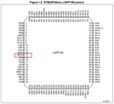

Please give the full schematic.
@Kumar123 wrote:On my STM32F407VET6 board, the RESET pin is connected to GND, and I'm using the SW3 button for reset.
That doesn't make sense - connecting Reset (NRST) to ground will hold the processor permanently in reset - so nothing will ever happen
V = 100 pins;
T = LQFP.
So Reset (NRST) is on pin 14:

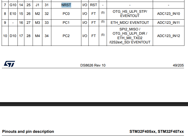

2025-06-05 4:50 AM - edited 2025-06-05 4:52 AM
@Kumar123 wrote:Can the NRST pin be used as a GPIO output pin.
No - see the datasheet:
https://www.st.com/resource/en/datasheet/stm32f407ve.pdf#page=49
via: https://www.st.com/en/microcontrollers-microprocessors/stm32f407ve.html#documentation
@Kumar123 wrote:in the .ioc configuration file? It is not showing up.
The configuration tools won't offer options which aren't available in the hardware!

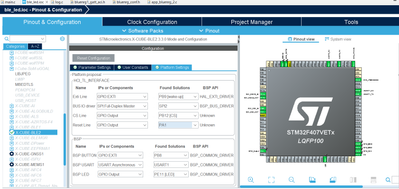

2025-06-05 10:22 PM
Hi Andrew
I have created the .ioc configuration as shown. Can you confirm whether it supports BLE? The file is attached.
