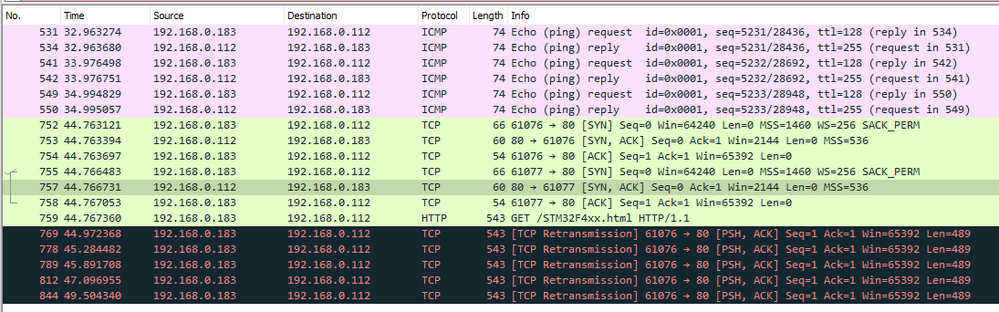

No I don't get HardFault, or other error handlers: the default task is running even after the LWIP stack stops working.
What I see now is that http_send() is called. http_write() cycles as the whole 9820 bytes of the page were sent but there are no packets on LAN (192.168.0.112 is the board, you can see the ping at the beginning).
