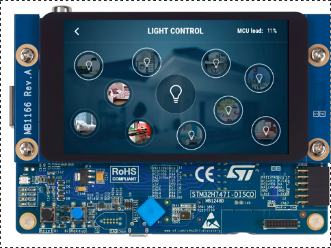

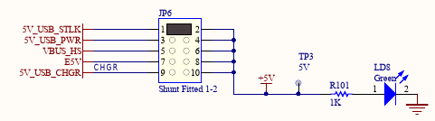

so you have this ?
is the demo running ?
led8 ON ?
jp3 ?

The green led D8 is on.
After that, I still have the same error on stm32Cube programmer. I cannot flash anything. So no demo
