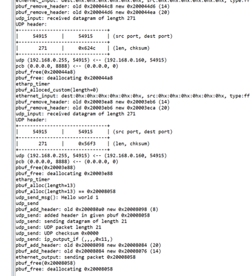

The main file I used was C++, so I changed the log output method as shown below and it worked well.
/* USER CODE BEGIN PD */
#ifdef __cplusplus
extern "C" int _write(int32_t file, uint8_t *ptr, int32_t len) {
#else
#endif
for(int32_t i = 0; i < len; ++i) { ITM_SendChar(*ptr++); }
return len;
/* USER CODE END PD */

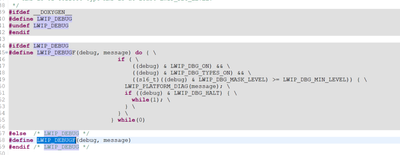

If you trace into the source code of LWIP you can see what the problem is by evaluating the source code, one example:
In my case:
so UDP_DEBUG was on, that seems ok.
But if I check LWIP_DEBUGF i see:

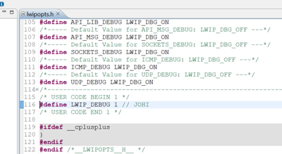

The grayed code is not active, analysis of the code learns that LWIP_DEBUG is not defined.
In most cases I define it in LWIOPTS.H:

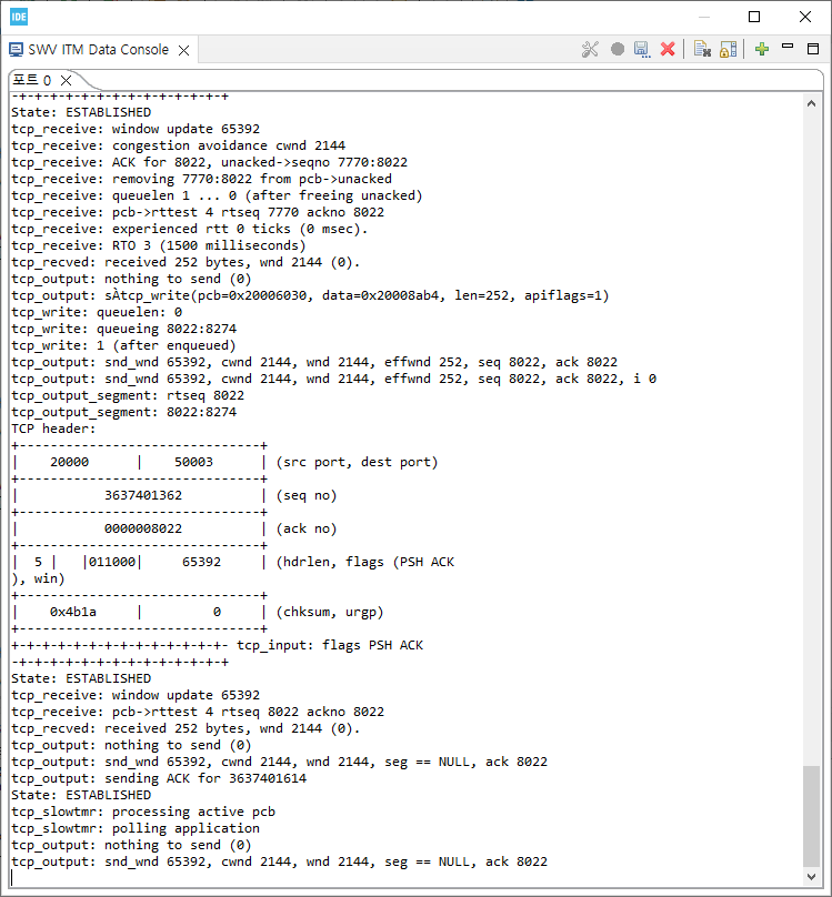

And then I get in my SWV ITM console window:

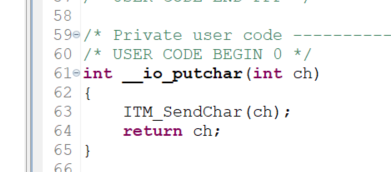

But in my main.c I need to add:
As you are using USART3, this code will need an alternative.
2023-12-25 11:04 PM
Johi, thank you for your explanation. By adding some modifications, the output of LwIP's debug log was successful.
