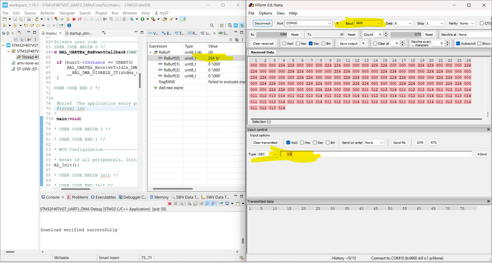

connect to computer using software terminal "HTerm"
Set baud rate 9600 STM32F407 can receive
But i change to other baud rate such as 115200
then i change baud rate 9600 can not receive

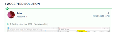

2024-01-14 5:16 PM

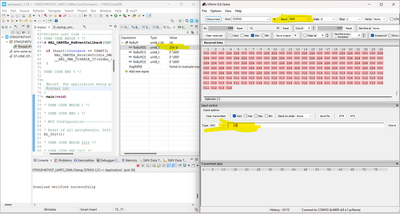

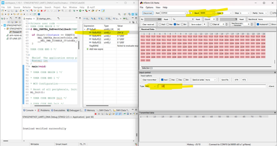

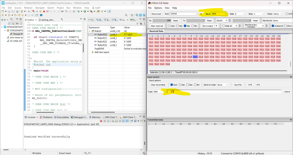

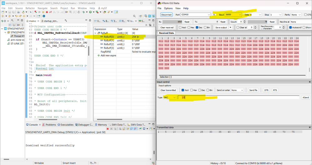

1. Setting baud rate 9600 HTerm is working
2. Setting baud rate 56000 HTerm is working
3. Setting came back baud rate 9600 HTerm is not working

2024-01-14 5:16 PM
2024-01-14 5:17 PM
Thank you.
2024-01-14 5:17 PM
Thank you
