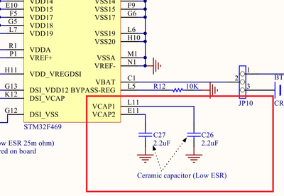

Each of the VCAP capacitors should be 2.2uF
2024-12-05 2:24 AM
Indeed and with low ESR. From AN4488:

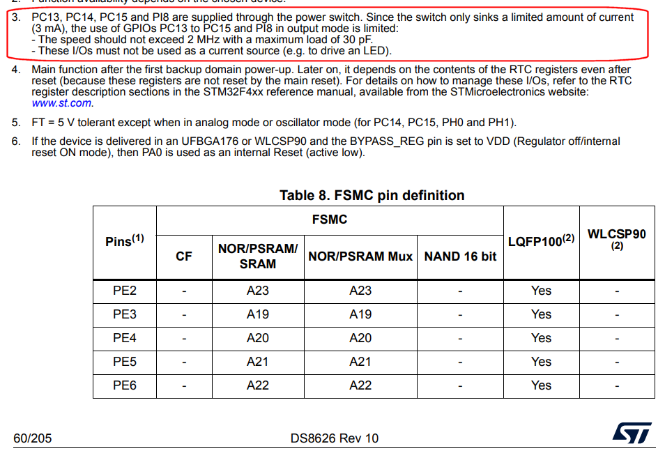

@huhuhaha wrote:the STM32F405RGT6 seems had no problem (because it still managed to be debuged and programmed).
What, exactly, do you mean by "debugged" here?
Have you stepped through the LED-blinking code? Does it successfully go through the code to set the pin high & low?
What do you see if you probe the pin externally?
If you set the PC13 output low, and then externally short the LED cathode to GND - does it light?
PC13,14,15 and PI8 are subject to limitations:
https://www.st.com/resource/en/datasheet/stm32f405rg.pdf#page=205
You should be OK with sinking the current for your LED D1:
https://community.st.com/t5/stm32-mcus-products/stm32f030-pc13-14-15-current-sink-limits/m-p/717014
But what does REF_DIR do on PC14 ?

I also think of that. but i still finding the problem of my blinking led
2024-12-05 2:48 AM
wew, i just found out that information. i will try it
2024-12-05 2:49 AM
Thanks for the reference, i will try it
