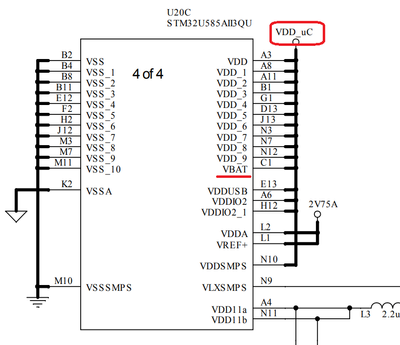

According to the schematics you attached, VBAT pin is hardwired to VDD_uC and not to a dedicated battery cell. So if you lose the power on VDD_uC you will lose the Time/date. So you need to keep VDD_uC powred on.

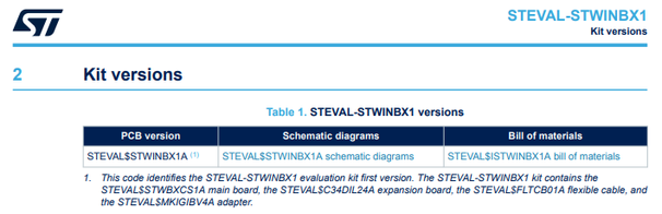

Well, maybe you can find someone who can confirm whether VBAT is connected uninterrupted to battery on this board. I can't, not that proficient. In the user's manual are two links (in blue) to further details but those are dead:
I was however able to google the schematic:
Well, that board is a (likely multilayered) ST board, so either you or I will have to file a report if this is to be fixed in a future version.
I think connecting VBAT to VDD was an option of the design I think for simplification and this is something we can see in many ST boards like Disco board for example.
I've already escalated this remark a moment ago .. I don't know if it will be taken in consideration or not.
