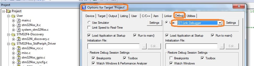

U-LINK != ST-LINK, pick the right debugger

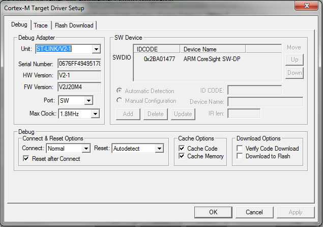

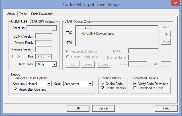

Here is a visual representation of the issue. on my working system, i get:2015-05-25 9:22 AM
Hope that is clearer than my original post.
Your post was clear, but the ST-LINK is still not aU-LINK
, you still need to select the right debugger in the debug pane, then the settings will work.2015-05-25 4:24 PM
Do you mean the debug pane shown in the picture above? as you can see, there is nothing listed there at all!
in the first window, it defaulted to the ST-LINK shown. in the 2nd window, it doesnt show anything at all, which seems to be the cause of the problem. is there somewhere else i need to select this for it to show up here?2015-05-25 7:16 PM
