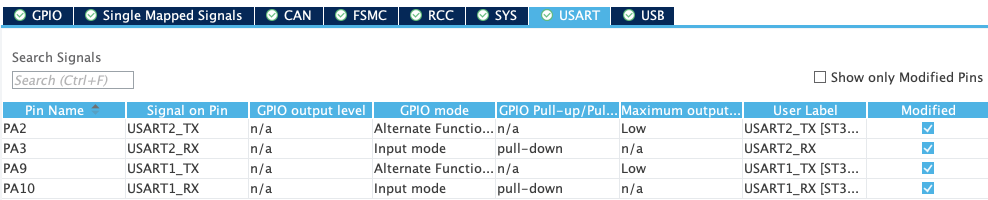

Hello, I'm building a project where I will use CAN, UART and a TIMER. All of these work with an interrupt. How it works: I get data via CAN and use a TIMER to send a Request on the CANbus. With the UART I need to receive some commands that will trigger some functions. I have provided my code. In this code everything is working except for the UART interrupt. I had a different project with UART where everything was in the main, so I copied that to see if that is working, but it doesn't work. The UART interrupt is not getting triggered, but in the separate project it is working where I only use UART. What is wrong?

2024-01-23 4:27 AM
I got it working. I didn't look at the PIN settings. The receive pin (PA3) of USART2 was set to GPIO mode, but it should be input mode.
2024-01-23 4:51 AM
Well, that's why you need to isolate the function having the issue to surround it quickly ;).
