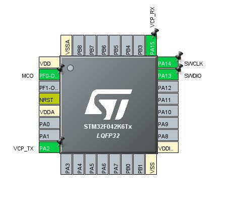

2023-10-19 5:30 PM
By default, cubeMX assigns USART2 Tx and Rx to PA2 and PA3. According to the STM32 manual, for virtual communication (USB), only PA2 and PA15 are used. I had to change PA3 to PA15. Now the program works.
2023-10-19 5:47 PM
When you start a new Nucleo-F042K6 board project it configures VCP correctly. You ended up creating a new project for just a STM32F042 which defaults to PA2 and PA3.
2023-10-19 9:54 PM
Mine always defaults to PA2 and PA3 when I create a new project.
2023-10-19 10:30 PM
I just explained that you need to start a new BOARD Project.
