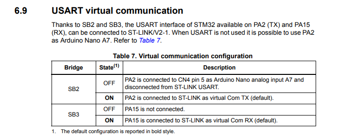

By default, cubeMX assigns USART2 Tx and Rx to PA2 and PA3. According to the STM32 manual, for virtual communication (USB), only PA2 and PA15 are used. I had to change PA3 to PA15. Now the program works.

What board is this? How are USART1 and USART2 connected externally? Where is the signal on UARTx_RX coming from? Your code doesn't do anything with the received data. How do you know it's not working?
Probably a hardware issue. Either the pin isn't connected, or the signal isn't coming in where you think it is. Or possibly a misunderstanding of what should be happening.
