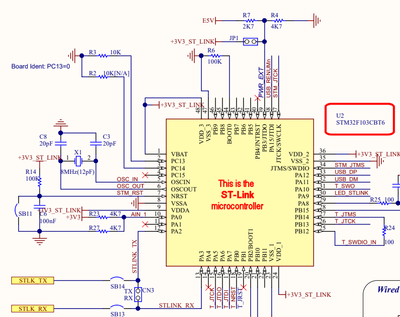

Are you, perhaps, looking at the ST-Link microcontroller - U2 on Sheet 4 - which is an STM32F103CBT6 ?
The STM32F030 is U5 - marked "MCU_LQFP64" on Sheet 3.

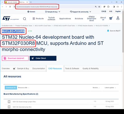

This is the link that @STTwo-32 gave:
https://www.st.com/en/evaluation-tools/nucleo-f030r8.html#cad-resources
It does take you to the Product Page for the NUCLEO-F030R8 board:

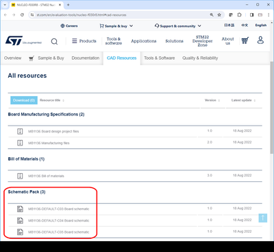

Scroll down to find the Schematics:
Download the pack which corresponds to the revision of board (C03, C04, or C05) which you have.
Note that the schematics are also in the 'Board design project files' download.
