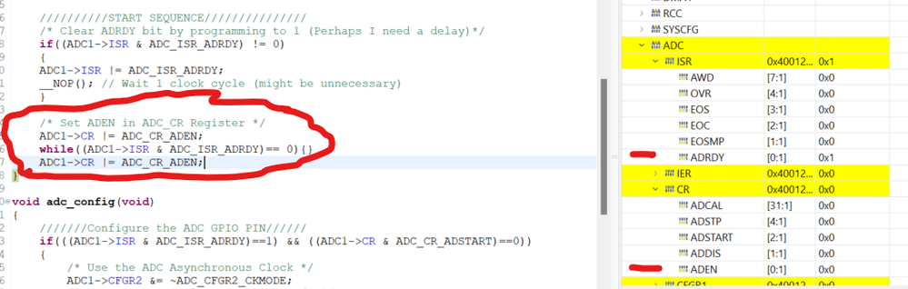

This code only works when I'm debugging step by step. Otherwise, it always sends ADEN low again, which should not happen!! (Correct sequence: ADEN goes high then ADRDY goes high and both stay high...) (Note both ADEN and ADRDY are low before line 54 of pa1_adc_init() function)

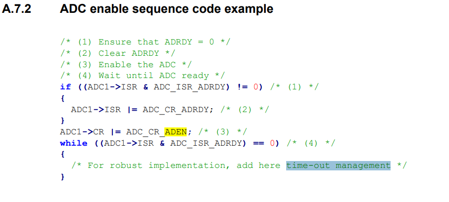

The reference manual says...
Maybe I need this "time-out management" but I don't have a watchdog timer enabled so unless I'm understanding incorrectly, I don't think that's the issue.
The issue occurs on lines 56 and 57 of my pa1_adc_init () function below.

This is incorrect: as ADCAL is nonzero after setting it - calibration is ongoing - program never enters this loop and proceeds to enabling ADC through ADEN - and this fails, as hardware does not allow to set ADEN while calibration is ongoing.
Look at the example in RM, which is:
ADC1->CR |= ADC_CR_ADCAL; /* (4) */
while ((ADC1->CR & ADC_CR_ADCAL) != 0) /* (5) */
/* For robust implementation, add here time-out management */

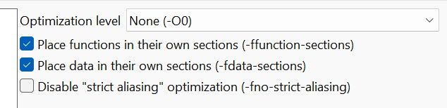

Are you using different Build settings for the two test scenario (the step by step debug and the Run).
Could you check the optimization level?

2023-02-15 5:10 PM
Hi @Semer CHERNI ,
I am not using 2 different build settings for the 2 scenarios. In both I am using the debug perspective. The only difference is where I set the breakpoints. (Line 55 vs line 65)
My optimization level is set at the default (No optimization)
