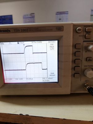

Yes, I have configured the pins as open drain, so that isn't the problem.
Following are the outputs i observed on the dso-
 This is the start condition

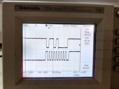

 And this is the slave address.

You should put external pullups so SDA/SCL are idle high. At the start of your start condition, both are low, which is not a valid state to start off with. May or may not be okay.
At the end of your start condition, you have SDA low and SCL low, which is good.
At the start of your slave address, SCL is now somehow low again. That's a problem and suggests other things are happening between start condition and sending the address.
Ignoring/hardcoding ACK isn't ideal and robs you of knowing whether or not the slave is responding.

In your scope photo, I see only 8 clock cycles.
The I2C protocol requires 9 clock cycles, 8 for data bits and the 9th for ACK.
Thank you for sharing this post. I have referred it previously, but I will go through the repo once again to get a point of reference.
Yeah, that issue was actually caused because of a small delay I was using, I removed that delay, and now the ack clock pulse is visible.
Thankyou for bringing up the low SCL at the start. That was happening because of a small improper delay I was using.
