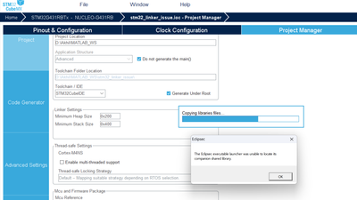

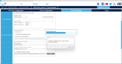

When I try to generate code from stm32cubemx v6.4.0. I'm getting an error message like "The Eclipsec execution launcher was unable to locate its companion share library.". I'm attaching the screen shot here
How to resolve this issue

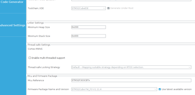

you changed settings for code.gen. ? ( + gen. under root , set it.)
see mine:

Come on - you set : do not generate main.
So what should it do then .. ? generate a lib ?
error: cannot find... -> So set the path to where the lib is, or leave it at the setting, Cube made as default.
