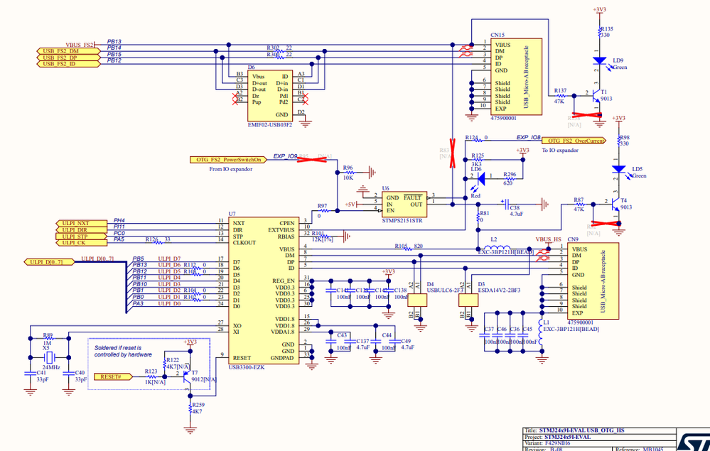

In Middleware Packages USB_ Host, FATFS is configured according to attached image.
MCU schematic and USB-PHY schematic is also attached.

No, I haven't used any evaluation board. However, below are the USB PHY connections
USB3300 Pins------ STM32F427 Pins
STP------------------- PC0 ------> USB_OTG_HS_ULPI_STP
DIR-------------------- PC2 ------> USB_OTG_HS_ULPI_DIR
NXT------------------- PC3 ------> USB_OTG_HS_ULPI_NXT
DATA[0]-------------- PA3 ------> USB_OTG_HS_ULPI_D0
CLKOUT------------- PA5 ------> USB_OTG_HS_ULPI_CK
DATA[1]-------------- PB0 ------> USB_OTG_HS_ULPI_D1
DATA[2]-------------- PB1 ------> USB_OTG_HS_ULPI_D2
DATA[3]-------------- PB10 ------> USB_OTG_HS_ULPI_D3
DATA[4]-------------- PB11 ------> USB_OTG_HS_ULPI_D4
DATA[5]-------------- PB12 ------> USB_OTG_HS_ULPI_D5
DATA[6]-------------- PB13 ------> USB_OTG_HS_ULPI_D6
DATA[7]-------------- PB5 ------> USB_OTG_HS_ULPI_D7
There's no dedicated VBUS sensing on STM32F427 pins.
VBUS power switching is controlled by CPEN pin of USB3300 PHY
which in-turn controls the EN pin of switch AP22653(used to to supply 5V to VBUS pin of USB drive).You can refer to USB PHY schematic I have attached for reference.

Would you attach your IOC file?
Check this schematics using STM32F429.

Also, NXT and DIR are assigned to PH4 and PI11 respectively. But this is not the issue.
At this stage I would focus more on confirming with a scope or logic analyzer that:
You can test the example provided in CubeF4 for high speed instance.
