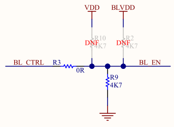

Backlight control has changed from this (rev A):
to this (rev B):
That's the only change.
So double check the BL_CTRL signal. For instance, you could try to remove R9 and fit R10 or R2.
2026-02-02 7:29 AM
Thanks for the answer. A bit strange why on the booth LCD boards (A and B version) the BSP example working without any problem. Probably move R9 into R10 place could be working solution.
2026-02-02 7:42 AM
Hi again,
not sure, as I don't have the source code,
but, on rev A, as there is a pull-up resistor, the backlight is on by default, and if the factory demo binary was developped without driving the backlight pin (that could have happened), it will only work on rev A. With rev B, it is mandatory to drive it.
