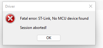

hi all,
I am using STLINK/V2 ISOL which says ST_LINK, No MCU device found, just replacing with STLINK/V2 works keep all setup intact.
what could be the reason.

2023-09-14 9:09 AM
i bought it from RS , I think it is an official product. I am using stm32L051rz.
It flashes fine with ST-LINK/V2 , but not with ISOL.
2023-09-14 9:47 AM
your target is powered ? because st-link isol has no power output , st-linkV2 has power out.
so check voltage on your L05 board, when using st-link isol .
2023-09-18 1:52 AM
Ok , that might be the difference, i thought both are the same apart ISOL. i will check it again. could you please point out the power out difference in the datasheet.
2023-09-18 3:00 AM
UM1075, Table 4, Vdd + GND :
