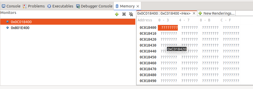

2026-01-26 10:05 AM
Hello @Jocelyn RICARD ,
I tried to read the memory using STM32CubeIDE as you suggested: using the Memory view I read only question marks as in the image shown below; as expected, the execution doesn't stop in any of the breakpoints.
The same process with the Nucleo board leads me to a correct read in the Memory view and breakpoints work as expected.
Thank you,
Giulio

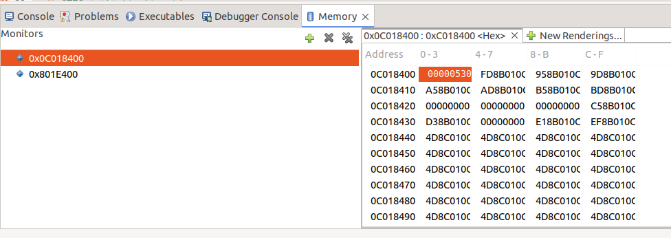

2026-01-27 10:31 AM
I confirm you that the two boards were in PROVISIONED state and that I reopened the debug by authenticating with key and certificate before reading the secure zone memory.
I also tried to provision both boards in OPEN state getting the same results: that is, the H5 in the NUCLEO shows a memory mapping as expected while my custom board not.
However, I have found something with a more careful analysis of the complete flash content: the flash of the H5 in the custom board does not seem totally empty: it shows some patterns but they seem shifted respect to the NUCLEO case. For example:
While the content of the memory of the Nucleo H5 matches the expectation, that of the custom board does not, because the code seems to be placed at the secondary slot of the secure area. Indeed, the flash layout header of the application says:
#define FLASH_AREA_0_OFFSET 0x18000 /* Secure app image primary slot offset */
#define FLASH_AREA_0_SIZE 0x6000 /* Secure app image primary slot size */
#define FLASH_AREA_1_OFFSET 0x1E000 /* Non-secure app image primary slot offset */
#define FLASH_AREA_1_SIZE 0xA0000 /* Non-secure app image primary slot size */
#define FLASH_AREA_2_OFFSET 0xBE000 /* Secure app image secondary slot */
#define FLASH_AREA_2_SIZE 0x6000 /* Secure app image secondary slot size */
#define FLASH_AREA_3_OFFSET 0xC4000 /* Non-secure app image secondary slot offset */
#define FLASH_AREA_3_SIZE 0xA0000 /* Non-secure app image secondary slot size */.
At this point, it seems that something wrong is happening in the memory management, but I can't figure why. Do you have any ideas? I have attached the flash memory contents of the two boards.
