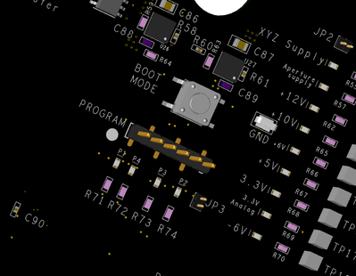

2024-12-11 3:54 AM - edited 2024-12-11 4:56 AM
Thank you, Kevin. I too purchased the device without paying close attention to the connecting cable. Shame on me as I worked this same issue in another job with TI processors/debuggers. It is sad that without the adapter I will make, the promise of good power profiling and correlation with the running firmware is lost.
I will have to cobble up to solve it, or engineer my own board.
Pictured is a legacy board.

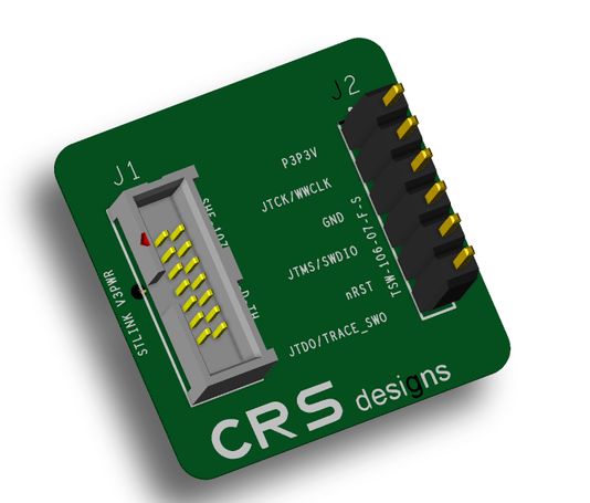

2025-01-06 10:05 AM - edited 2025-01-07 7:50 AM
So, I made one...
Seems like it should have been included in the box.
