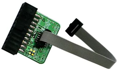

Maybe something like these?
https://www.mouser.co.uk/ProductDetail/Olimex-Ltd/ARM-JTAG-20-10
https://www.mouser.co.uk/ProductDetail/Segger-Microcontroller/80602
https://uk.rs-online.com/web/p/development-tool-accessories/1311329
They cite J-Link, but the 20-pin header is pretty standard?
2024-12-10 7:55 AM - edited 2024-12-10 7:55 AM
The first and last item on the list may be what will work. (The links are dead here in the US.)
