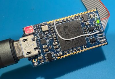

2025-08-27 4:39 AM - edited 2025-08-30 5:11 PM
I’ve just realized that debugging will not start without detecting the target voltage (pin 3 connected). This voltage is likely required by the level shifters. My custom probe doesn’t provide the target voltage, since I can use only four pins, and in addition to GND, SWDIO and SWCLK, I need TX. Below is working workaround I just tested.
Needless to say, this solution can be used with 3.3 V system only. I purposely used older STLINK-V3MODS because it is easier to modify.
