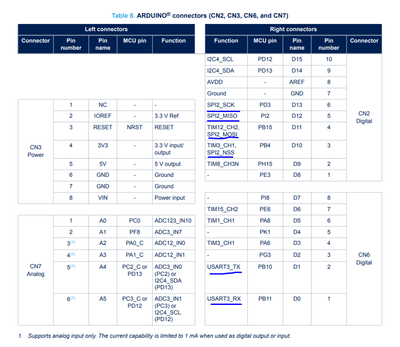

Yes I am testing debug mode, and yes i am using both cores in my example. Earlier I had toggled LED 1 on M7 core and LED 2 on M4 core in parallel and it was working.
Issue us that i am getting no response on UART or SPI pin of ARDUINO connectors given on board.
Mentioned below for your reference.
And below is the normal SPI data send code - (tried with and without DMA both) along with configuration, also attaching complete example project for further reference. On checking clock via oscilloscope there is no waveform on board pin D13 or MCU pin PD3.

/**SPI2 GPIO Configuration
PD3 ------> SPI2_SCK
PI2 ------> SPI2_MISO
PB15 ------> SPI2_MOSI
HAL_GPIO_DeInit(GPIOD, GPIO_PIN_3);
HAL_GPIO_DeInit(GPIOI, GPIO_PIN_2);
HAL_GPIO_DeInit(GPIOB, GPIO_PIN_15);
