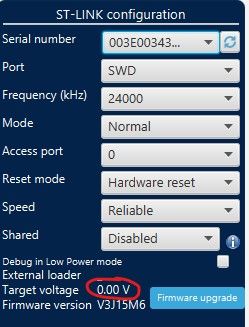

I have the STLink V3MINIE. When connected to the PC the red power LED is on. But I can't program any device because there is not target voltage.
ST Prog (v2.17) shows Target voltage 0.00 V
How can I fix this? Is there a jumper or solder connection missing on the stlink? Or is the board damaged?

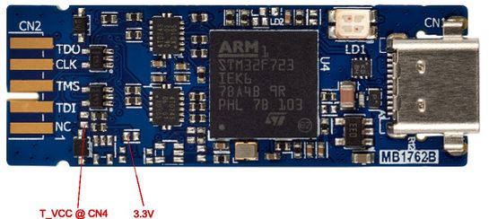

I have connected the stlink to a custom board, was not aware, that the MINIE does not give out a voltage.
If I power my PCB externaly it works and the voltage is displayed :)
What is the suggested way to program a STM32 that has no external power only with a STLINK?
I found a pin that has the needed 3.3V on the MINIE board. Would it be save to connect these 2 pads if current consumption of my PCB is low?
Is there a schematic availible for the MINIE board?
You need to get it power somehow. It's up to the board designer to determine how best to get it power. How will it get power when the programmer is not connected?
Likely, yes. If it's directly off of the LDO on the board, almost definitely yes.
Unfortunately not.

There is a way to power the board when in normal use. But how do people usually power the STM32 for programming in production? Or do I need to build a custom board using the STLINK-V3MODS?
It really would be nice to have a (solder) jumper on the STLINK boards to send power to the T_VCC pin.
My initial question is answered now, thanks!
