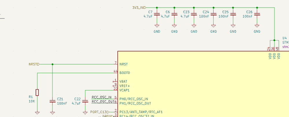

Hi there.ive recently made my own circuit board which and I having trouble getting the stlink v3 to detect my f411 mcu. I've checked my oscilloscope and I can see the swd, swclk , and reset lines being driven by the programmer but I'm unable to get the cubeide to detect my mcu. The power rail is also clean too.

For F411, make sure VCAP capacitors and voltages are correct. The VDDA is powered, as this deals with the POR and PLL too, not just ADC/DAC
Check state of NRST
Check part orientation
Test with STM32 Cube Programmer, first

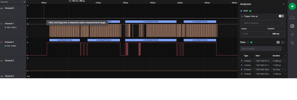

Cheers for the confirmation! I'll have a look. I have taken a capture of the SWD lines here.

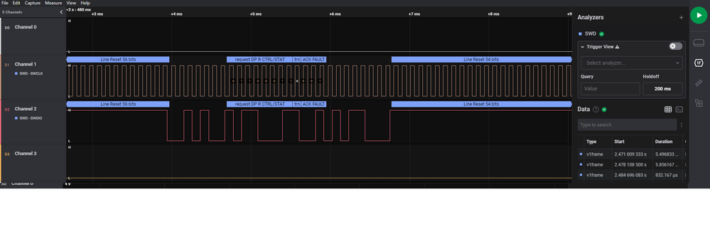

I've lowered the speeds. For some reason, there's an ACK failure after the turnaround. I'll have a look at your suggestions. Thanks

All of the required caps and voltages are connect too

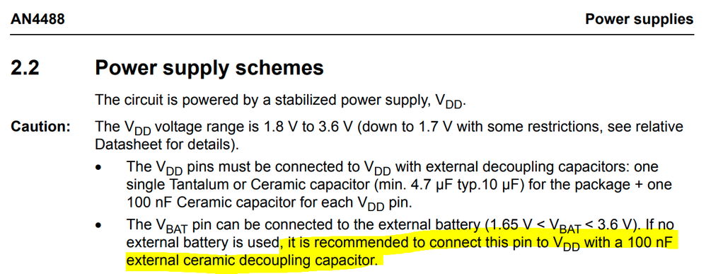

Is it required that I connect VBAT to VDD?

What voltage do you measure at VCAP1 ?
VREF+ should be connected to VDDA
Data Sheet:
If VREF+ pin is present, it must respect the following condition: VDDA-VREF+ < 1.2 V

Thank you! The problem was with the vref pin not being connected!!!
Not required, but recommended.
Also see STM32F4 design guide here:
