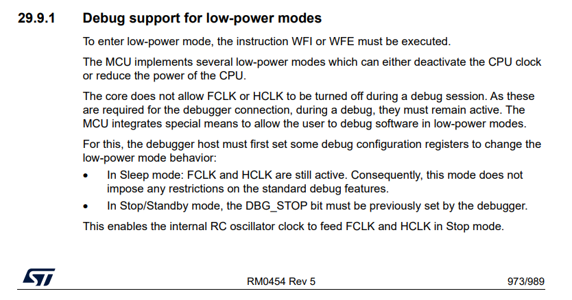

As @Peter BENSCH said, the debug (including programming) is not accessible when the CPU is asleep.
See this recent post (for a different STM32, but the principle is the same).

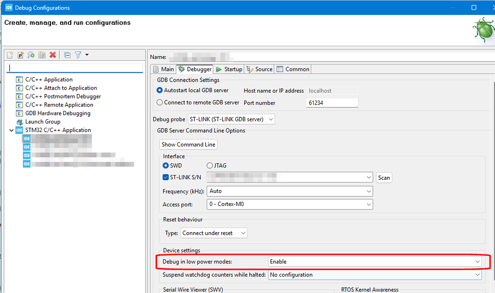

This is what the 'Debug in low power modes' CubeIDE setting does:

2026-01-14 7:59 AM - edited 2026-01-14 7:59 AM
via: https://www.st.com/en/microcontrollers-microprocessors/stm32g030k8.html#documentation
