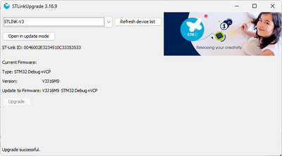

Just to be sure, what do you mean by "did not work when programmed with "STM32 Debug+VCP" V3J16M9" ? ST LINK doesn't connect anymore or you have an issue with the VCP?
From my side I have, the VCP is detected on Windows:
And I can connect to the board with STM32CubeProgrammer with the latest version of STLINK firmware: V3.J17.M10!

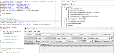

1. All I was talking about was the communication [µC -> PC] via the virtual com port. Programming/debugging always worked fine.
2. After further testing with the non-mass-storage option of the V3J16M9 with the integrated debugger I did receive data:
