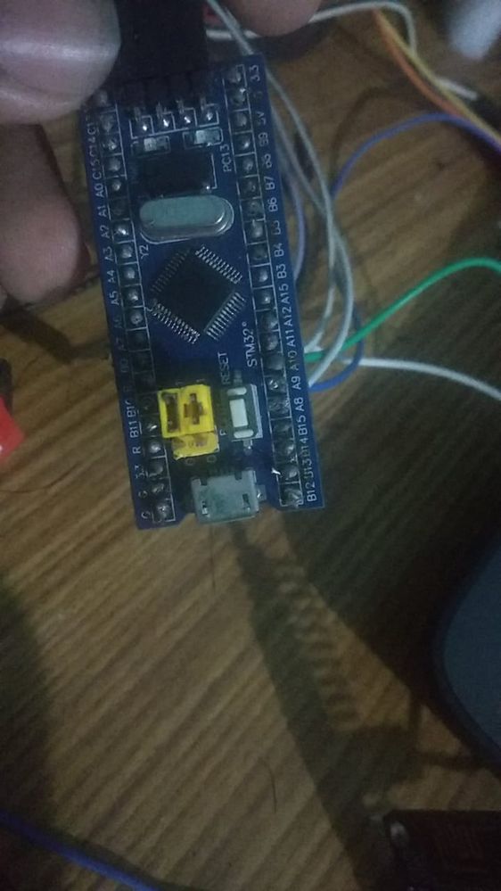

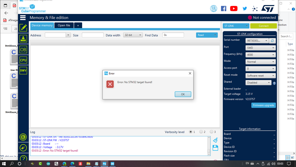

I have ST-LINK V2 Programmer and when I connect this with STM32MCU, it shows an error like this I have checked connections, jumper Wire.
Changed the port also. But still, it is showing No STM32 Target Found.
For checking Whether My Programmer is corrupted or not, I have checked ST-LINK with STM8 by connecting to SWIM pinout and it successfully uploads on to my STM8.
So is MY MCU corrupted or damaged, I have an STM32F103C8 Blue chip board.
And have configured its Boot Mode as shown in Pic.
BOOT 0 : 0
Boot 1: opened
Please Help, I am stuck on this for 2 days scratched my head but can't find what the is the issue??

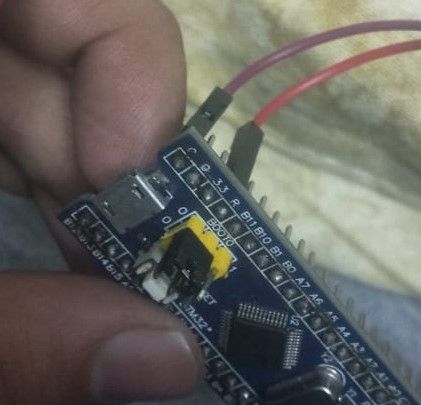

2021-01-21 3:12 PM
Well, I got the solution, I connected my Boot pins like this and then performed the erase chip thing in STM Utility with connecting under reset settings and my chip gets erased successfully and it is working fine now.

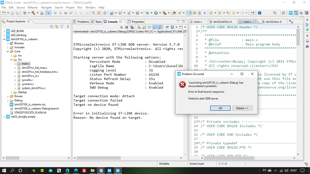

But Still, the Problem is coming with STM32CubeIDE.
It is not programming using STM32CubeIDE while successfully getting flashed with STM32CubeProgrammer. Seems there is a problem with my Setting of STM32CubeIDE.
I have raised this query with STM32CubeIDE in separate thread:

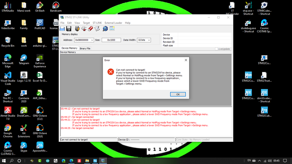

I am getting this error on ST-LINK Utility
I have connected SWIO, SWCLK, NRST pins of ST-Link to blue-chip.
And Connected GND pins and 3.3V of st-link to Blue chip respective pins.

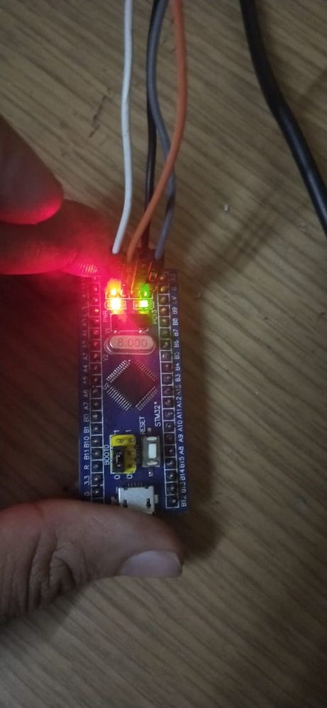

In first picture you published i observe PC13 LED is ON. Under reset must be off. An indication that a HW problem exists, is when you keep reset pressed and the PC13 LED doen't turn off.

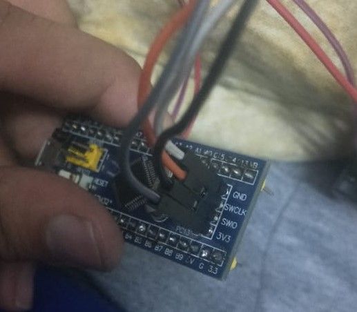

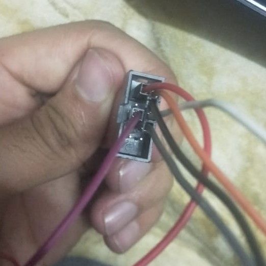

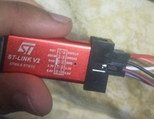

Show a picture of the connections to the ST-LINK, preferably a picture of the connections at both end, at high resolution and in-focus.
Are we sure this isn't using an STM32 clone part?
2021-01-17 11:56 AM
These are Connections,
For STM32 F103
White: GND
Orange: SWCLK
Black: SWIO
Grey: 3V3
Red: NRST
Magenta: GND
For ST-LINK,
White: GND
Orange: SWCLK
Black: SWIO
Grey: 3V3
Red: NRST
Magenta: GND
How to get to know whether my STM32 is cloned or not

Looks Ok
Does the board function?
Could be a board issue

are boot modes correctly connected ?
2021-01-17 1:55 PM
STM utilty is not able to erase the chip.....
so could it be that it is not able to communicate with STM32 MCU because it might got corrupted.
2021-01-17 2:16 PM
Really shouldn't make a lot of difference.
Set BOOT0 to 1 so it doesn't run code from FLASH, but I'm still leaning toward it being a chip/board issue. But I can't read the part number
