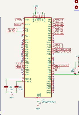

2023-09-20 6:18 AM - edited 2023-09-20 6:21 AM
Your schematic symbol is missing pin 63 (VSS). If this is left unconnected on the board, it would explain the error.

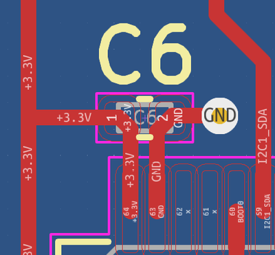

2023-09-20 6:28 AM
It indeed doesn't show in the schematic for some reason but it is connected.
