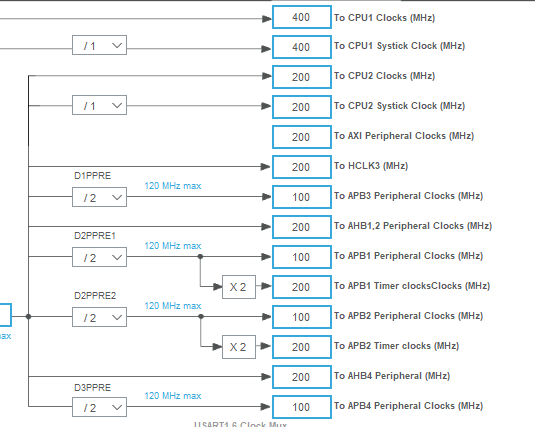

OK, according to your suggestions I set proper config supply and voltage scale. SystemClock_Config is as follows:

}Clock configuration is: f_{CPU,1}=400MHz on CM7 and f_{CPU,2}=200MHz on CM4, source: PLL. I flashed the program twice, second time after erasing the chip. Still the same error. I think this might be somehow related to PLL. Default clock configuration in Cube is not using PLL, PWR_LDO_SUPPLY is set instead of PWR_DIRECT_SMPS_SUPPLY and with this I was able to hit the breakpoints in main loops of both cores.
