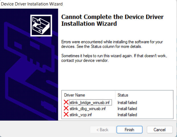

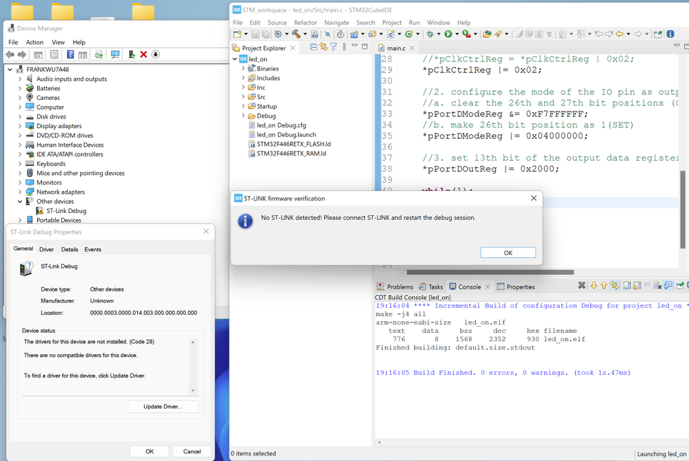

2022-09-18 4:19 PM
I have tried many ways to solve this question.
Is anything I missed? Please help. Thanks so much!
My OS is windows 11.

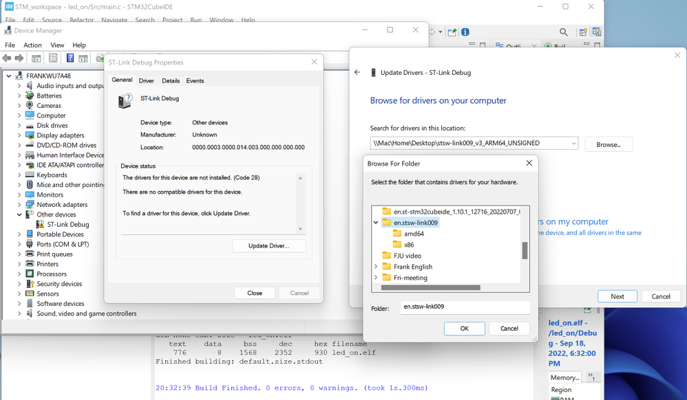

2022-09-18 4:31 PM
Unpack the .ZIP to an actual/real directory
Device Manager,
Update Driver
Specify a directory, that of the amd64 subdirectory as unpacked above
Make sure there's not any AV software or settings blocking driver installation.

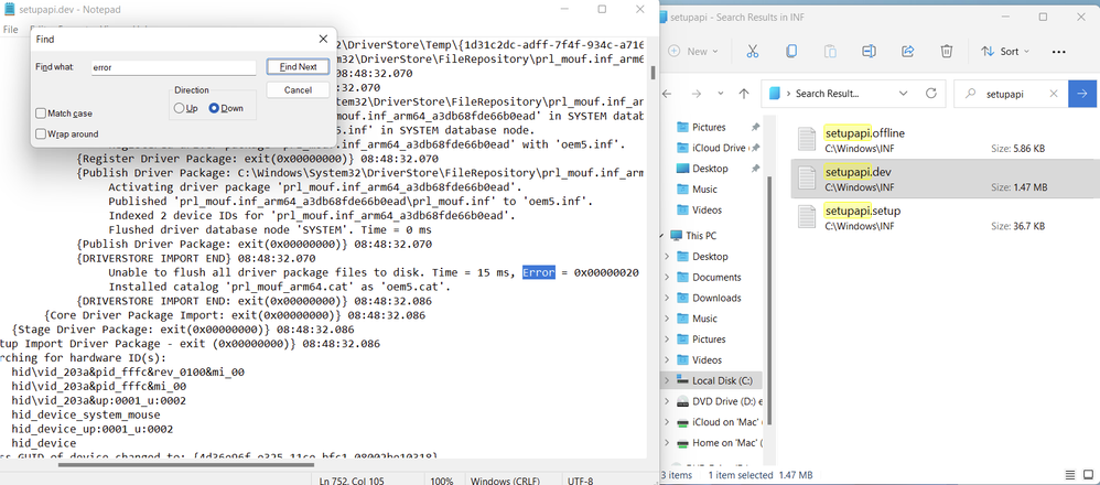

2022-09-19 7:44 AM
Please find this file on your PC: C:\Windows\INF\setupapi.dev.log
Is there any error related to installation of these drivers?

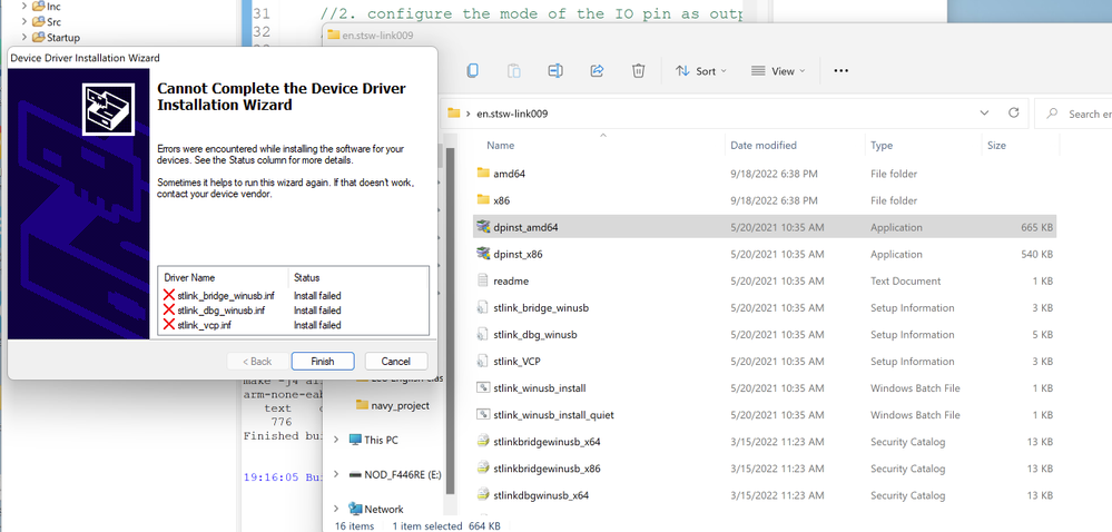

2022-09-19 9:05 AM
I have tried solution3(Solution 3: Disabling Enforcement through Startup Settings) from
https://appuals.com/how-to-fix-the-third-party-inf-doesnt-contain-digital-signature-information/
which is the solution from
but still could not solve my issue... and showed me the same thing...
2022-09-20 5:29 PM
@FWu.3 The posted log file screenshot does not show anything related to st-link (it is not a mouse). It is not obvious that the problem is caused by wrong signature.
