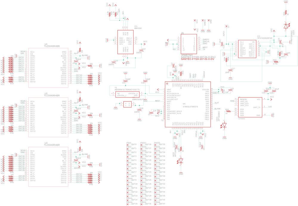

Circuit (programmer given by SAMTECH part) (zoom in to see):
When I connect STLINK V3 Mini to program the STM32L4676RG MCU, it detects the chip without errors. However, when I try to flash, STLINK generates fail.text.
Any idea what's happening?

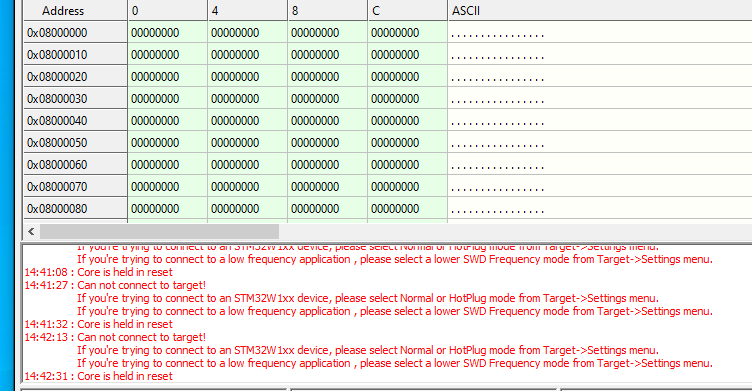

2021-03-24 2:51 PM
Ok here's what I tried:

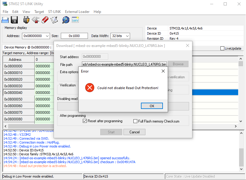

2021-03-24 2:55 PM
In addition, when I try to forcefully upload a bin file by bypassing readout protection, I get the following error:

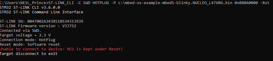

2021-03-24 3:52 PM
Output of STLink CLI
