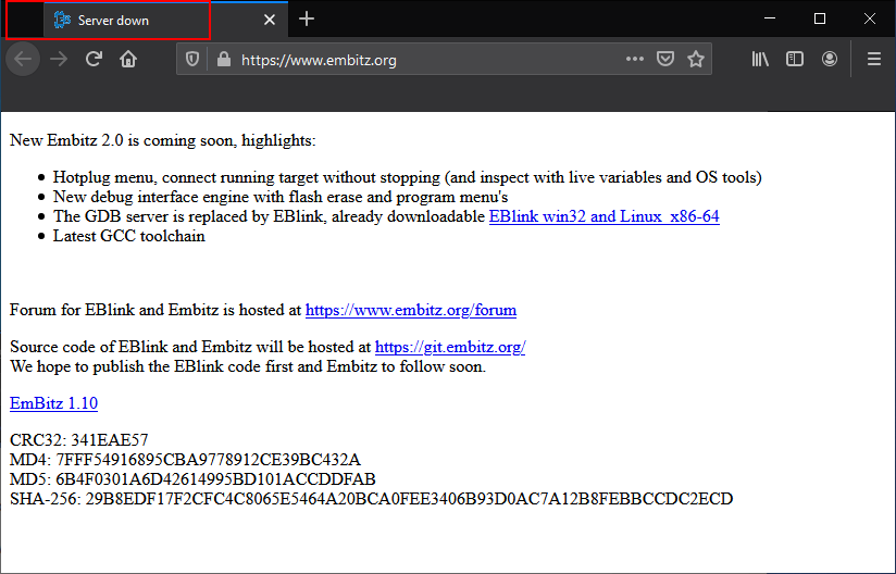

For serious development EmBitz is also a nice fully free option. Make an empty project, add linker script, startup file, CMSIS files and off you go. The compiler is GCC and it works with ST-LINK and J-Link out of the box.
2020-07-11 2:15 AM
Embitz, really? The website doesn't look trustworthy to me. The latest release is from 2016.
2020-07-11 3:08 AM
Yes, really. Well, you see that the server is actually not down and a major release is coming... ;) Anyway all of that doesn't change the fact that the tool is great and does what it's intended for much better than Eclipsoids. It feels like a hybrid of uVision and Visual Studio. And, as it uses GCC, there is nothing to worry about the future, because your code is already written for GCC and you can migrate to anything GCC based at any moment.
