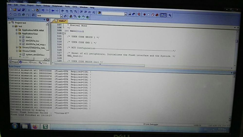

Ensure it's not write protected and try a full chip erase.

Check the flash algorithm settings down under the debugger settings.
Check banking options, if failing with dual bank, pick single bank, or reverse.
Check address of supported FLASH, can appear at a couple of addresses.
Make sure it recognizes you have an ST-LINK/V3, needs current drivers and DLLs.
Need one of the more recent MDK releases, V5.30 should be available current, wouldn't use anything older than 5.27
