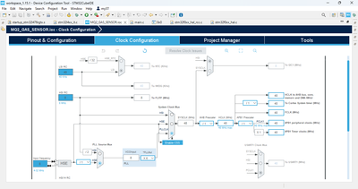

Here is the MCU IOC:

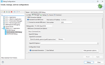

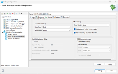

And my debugger settings:
Any help is greatly appreciated.

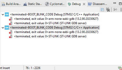

So where do I go from here? I've tried tweaking my debug settings for the ST-Link but nothing seems to work. It successfully bootloads every time and identifies the correct MCU, but this is what I get in the debug window:
I feel like its something trivial with the way I have the ide setup or possibly my clock configuration but I'm really not sure.

Don't know if this helps, but I tried a different debug configuration, and this is the result I got:
Open On-Chip Debugger 0.12.0-00029-gf77e7cb03 (2023-12-15-13:25) [https://github.com/STMicroelectronics/OpenOCD] Licensed under GNU GPL v2 For bug reports, read http://openocd.org/doc/doxygen/bugs.html Info : Listening on port 6666 for tcl connections Info : Listening on port 4444 for telnet connections Info : STLINK V2J45S7 (API v2) VID:PID 0483:3748 Info : Target voltage: 3.213158 Info : clock speed 1800 kHz Info : stlink_dap_op_connect(connect) Info : SWD DPIDR 0x0bb11477 Info : [STM32F030F4Px.cpu] Cortex-M0 r0p0 processor detected Info : [STM32F030F4Px.cpu] target has 4 breakpoints, 2 watchpoints Info : starting gdb server for STM32F030F4Px.cpu on 3333 Info : Listening on port 3333 for gdb connections Info : accepting 'gdb' connection on tcp/3333 Info : device id = 0x10006444 Info : flash size = 16 KiB Warn : GDB connection 1 on target STM32F030F4Px.cpu not halted undefined debug reason 8 - target needs reset Info : accepting 'gdb' connection on tcp/3333 Warn : GDB connection 2 on target STM32F030F4Px.cpu not halted undefined debug reason 8 - target needs reset [STM32F030F4Px.cpu] halted due to debug-request, current mode: Thread xPSR: 0xc1000000 pc: 0x0800060c msp: 0x20001000 [STM32F030F4Px.cpu] halted due to debug-request, current mode: Thread xPSR: 0xc1000000 pc: 0x0800060c msp: 0x20001000 Info : [STM32F030F4Px.cpu] external reset detected Info : [STM32F030F4Px.cpu] external reset detected shutdown command invoked shutdown command invoked

I found the solution,

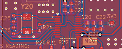

the board uploads when I have the crystal set internal instead of the external setup I have but I'm not entirely sure why. I chose the ECS-80-12-30-JGN-TR with two 20pF caps at CL1 & CL2, and have Rext at 0 ohm acting as a jumper for now.
I'm not entirely sure what's causing the bootloader to essentially get stuck at the end of the cycle when uploading it, but I'm assuming it has something to do with the way I set up the crystal.
Here is the layout on the board:
And the ide setup:
But at least now I can upload code to it and the ADC channel is working, albeit not accurately but it is reading values.
