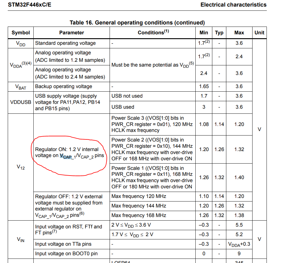

in VCAP_1 pin I measured 1.32 VDC.
Reviewed the STM32F446 datasheet but I am not actually understanding it well, but I guess the VCAP values are good.

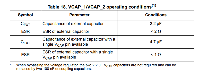

However, I've found in the schematics that the VCAP uses a capacitor in my custom board:
GRM31CR61E476ME44L which looks like it is 47uF and it should be of 4.7uF . Not sure if this should be something interesting to look and if there is a way to solve the issue.
Is it possible damaged? I'm honestly getting without options.:sad_but_relieved_face:
2020-08-12 11:57 AM
Replace the capacitor(s) with appropriate value
I don't think the wrong VCAP here will cause permanent damage.
