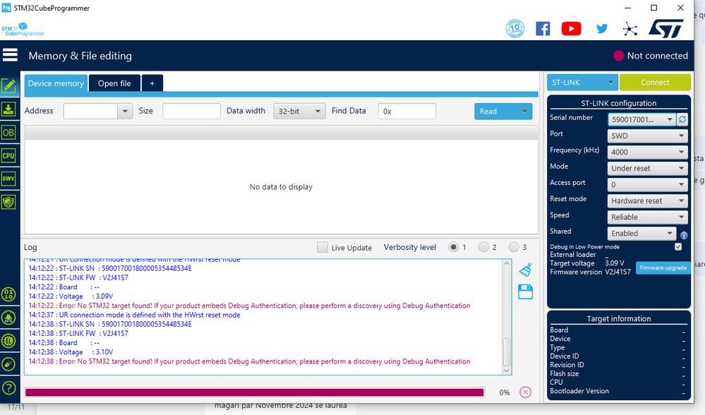

I have bought a new st link / v2 A 2022 08.
I am able to program my microcontroller with stm32cubeide as shown below
but when I try to program it which the same version of stm32cubeprogrammer I am not able to do it..
I click on connect but nothing happens..
Which are the differences with the previous st link h?

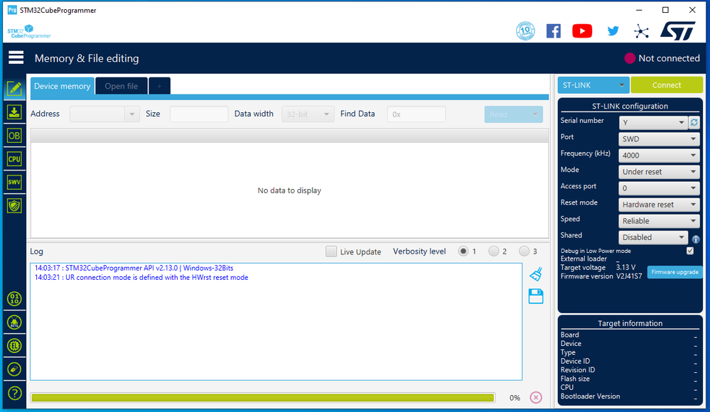

Hello @SGasp.1,
Could you do the same test with the latest STM32CubeProgrammer release (v2.13)?

Hi @Peter BENSCH makes sense what you said... But why I can program and debug the board with the stm32cubeide ? And it is not working only with the stm32cubeprogrammer?
Thanks
2023-05-16 2:34 AM - edited 2023-11-20 5:27 AM
Hi @Aziz BRIGUI .,. I will make an attempt.. Thanks
Here the result of the update
Any idea about the issue?

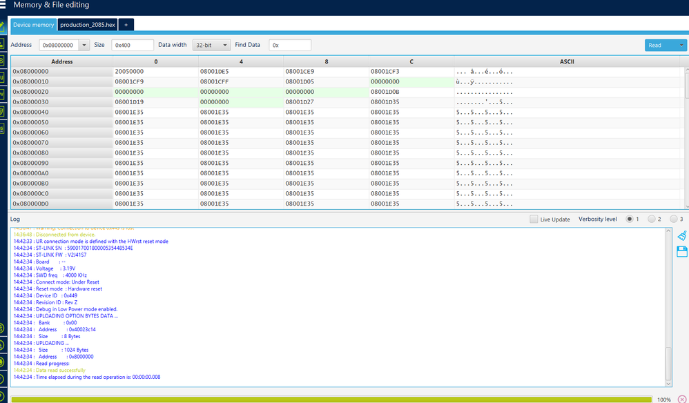

I was able to read the flash by changing the shared option from disable to enabled (using 2.13 version)

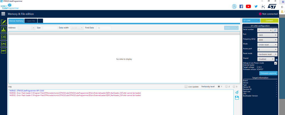

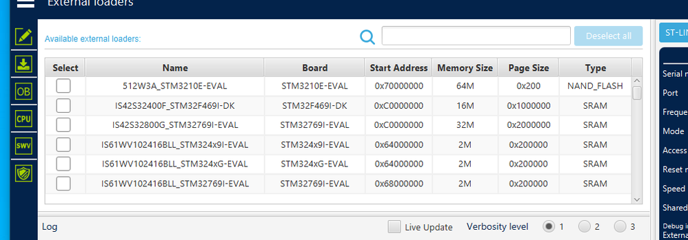

Now I want to try to download the fw but I have also an external loader too named QSPI_flashloader_CSP.stldr . I have added my custom bootloadr inside the externalloader folder under the 2.13 directory but i am not able to see it in the gui .
What could be wrong ?

STM32CubeProgrammer not working is version 2.8
STM32CubeIde working is version 1.7.0
