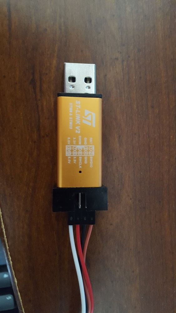

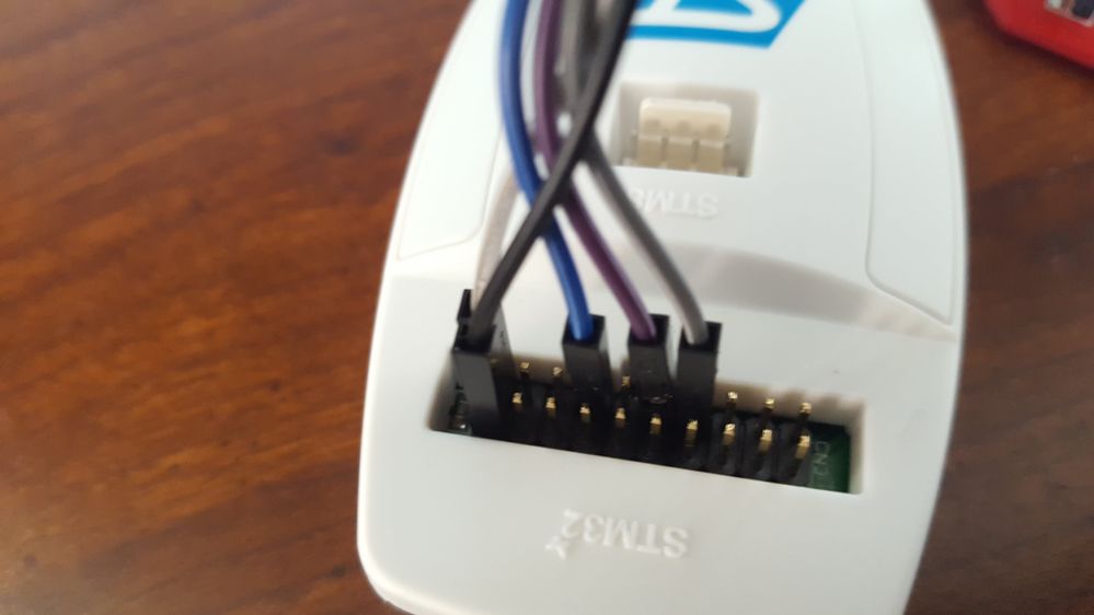

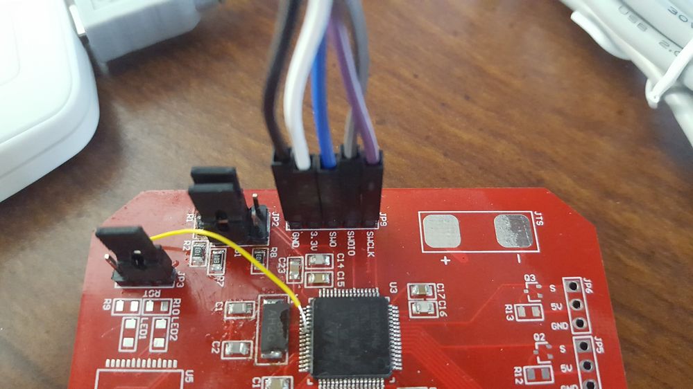

I then purchased the ST_LINK V2 programmer from ST but it doesn�t connect to the MCU (target). My laptop does recognise the ST_LINK V2 programmer since I have the stsw-LINK009 software installed. The SWCLK. SWDIO, and SWO pins are directly connected to the male headers as seen in the pictures.
Here are the Connections:
I also attached the trace.log file from STM32 Utility:

Note that what you show there is not an 'official' ST product - it is a cheap chinese knock-off.
I have noticed with these that the target connector pinout can differ from one item to another - so check the markings on the case carefully ...

Review the schematic, the error suggests the chip isn't running, or is wired up wrong.
Check voltage observed on NRST and VCAP pins.

The voltage on NRST pin is 3.27V, on VCAP1 pin is 1.12V and on VCAP2 pin is 0.20V.
By the way, could you please let me know: what voltage are correct on VCAP1 and VCAP2 ?
2017-12-30 7:35 AM
1.25V
Make sure the chip has the correct orientation.

Not sure you have regulator control on a 64-pin device.
You should perhaps compare your design with that of the NUCLEO board, making sure all the supply pins are wired up correctly and the pin numbers are all in order.
